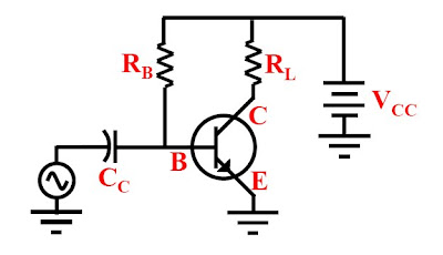

hey pinout, when we input an ac signal to transistor at it's base as we know that transistor is operated at dc level i.e we give +vcc voltage but as we are also giving ac signal won't this ac signal mix with dc supply?? how are they actually isolated??
You obviously have a good analytical brain and you are correct. Considering a common emitter amplifier such as this
https://4.bp.blogspot.com/_3b1TEwzFtQg/SgEyNoF6qWI/AAAAAAAAAIM/8u5108ATupQ/s400/Emmiter.bmp
RB sets the DC bias point and hence the voltage at the collector.
This circuit is a bad example to use in an application. The DC conditions are affected by the transistor gain and temperature.
Now your AC signal changes these DC conditions and that is what give you your AC gain.
The normal way of thinking about this is that the DC bias sets up the transistor in a stable way and the AC is modifying this to vary the transistor around this point.
If you want to look at some formula "h parameters" define the transistor from an AC point of view assuming the DC conditions are taken care of.
You last point where you say DC supply, I have answered the above assuming you mean DC bias or set point. From a beginners perspective the actual supply is considered perfect and stable.
