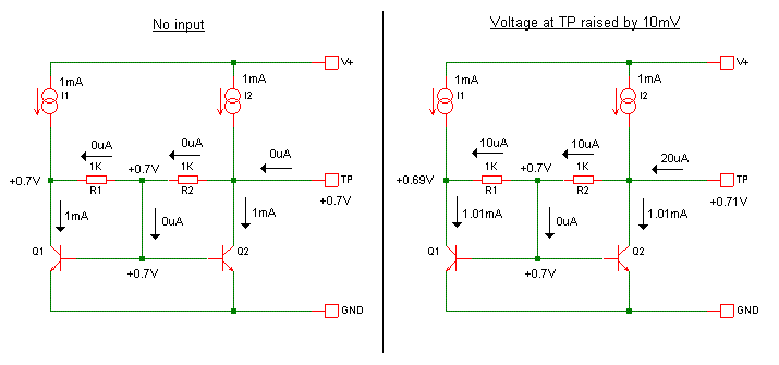

My analysis would be as follows:
Firstly, assume matched transistors, so the collector current of the two transistors is equal.
Let's say both resistors are 1K in value and the voltage on the right transistors collector is raised 10mV.
10uA will flow through the right transistor to the transistors' bases. This will tend to turn them both on harder. This causes the left transistor's collector voltage to drop, so current will flow from the bases through the left resistor to the left transistor's collector.
Equilibrium is reached when the voltage at the left transistor's collecter has dropped by 10mV, so that the current flowing out of the bases through the left resistor cancels the current flowing into the bases through the right resistor, leaving no net base current.
Since the current through the left transistor has increased by 10uA, the current through the right transistor must also have increased by 10uA. Thus the total current flowing into the external node connected to the right transistor's collector is 20uA.
The input impedance is thus 10mV/20uA = 500 Ohms = R/2

I agree with your analysis. The question was likely referring to the dynamic impedance which is indeed 1/2 R (as long as the input current is below the collector constant current source. Above that current the current-mirror no longer operates and the dynamic impedance will be reduced).

here some my thoughts about it:
1. If beta very hight, then base currents very low ~ 0.
2. Let's do small-signal circuit and calculate Rin:
check my attachment ^)
3. Assuming gm ~ inf, equal Rin reduces to R/2

Better yet, you can check my calculation since it is simpler. Tell me where I went off track.
Right here:
So, the source current contributed by the right transistor is beta *(Vs/R)
You are assuming that the base current of the right transistor = Vs/R but that's not true.
Vbe of both transistors is the same. Thus their collector currents are the same. The collector current of the left transistor flows through the left resistor from the transistor bases, cancelling most of the current flowing to the bases through the right resistor.

Yes, I see you are correct. The current in the left transistor skews the voltage at the junction of the the two R's. I did a node calculation which I won't publish here unless someone wants to see it. I did get the same result you did of R/2.
