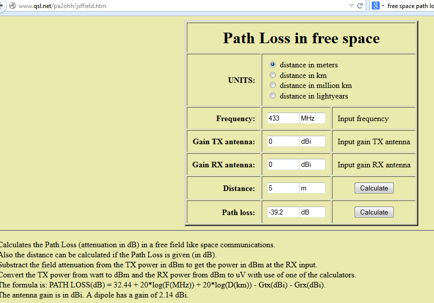

I calculated using the free-space path loss equation that for 5 m the loss in signal from the transmitter antenna to the receiver antenna is about 76 dB.
Considering the input power at the receiver antenna should be at least 0 dBm. Should the transmitter power amplifier pump (0 dBm + 76 dB) power to its antenna?
Sure? 76dBm = 46dbW = 40kW is used in large radio stations. Isn't this a bit too much for this simple task? Why do you want such a high level at the receiver? Normal receivers can operate with much smaller input levels.
Example here: https://www.maximintegrated.com/en/products/comms/wireless-rf/MAX1473.html
Input signal range is from -114dBm to 0dBm.
Also, my calculation of the path loss is different from yours. With the calculator below, assuming antennas with no gain (0dBi), the path loss is 40dB.
https://www.qsl.net/pa2ohh/jsffield.htm

    Debdut
Thanks very much volker@muehlhaus.
Actually I mixed up the formulae for path loss in km and in meter.
I'll look in the IC that you posted. I really need to brush up my basics.
