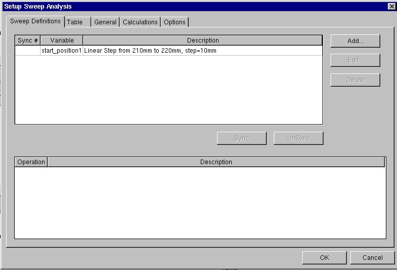

Here's my Parametric Sweep setup, using HFSS -> Optimetrics Analysis -> Add Parametric The simulation runs OK, with no warnings.

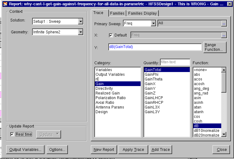

Here's how I have tried to plot the gain vs frequency, with HFSS -> Results -> Create Far Field Report -> Rectangular Plot

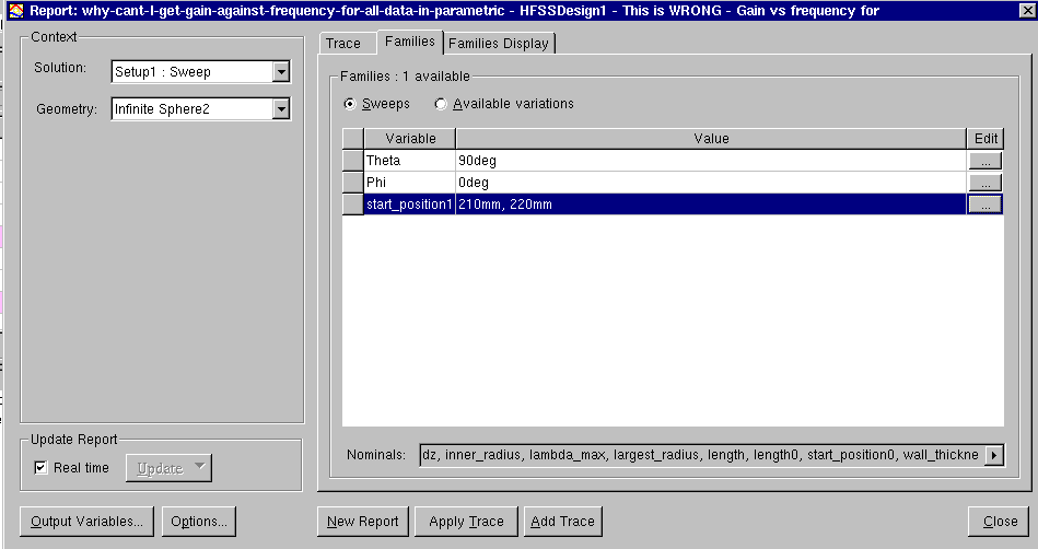

Here is the "Families Tab" of HFSS -> Results -> Create Far Field Report -> Rectangular Plot . Note this shows two values for start_position1.
I'm not sure what (if anything) I should expect on the Families Display tab of HFSS -> Results -> Create Far Field Report -> Rectangular Plot , but I see nothing at all.
