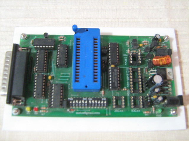

I have made the adapter and it does not work on my willem eprom programmer. I set the conf to 2732 but even when I erased the eprom it fails the blank test.
The strange thing is that when I read the eprom I see some "@" in the buffer in some locations. When I re-read the eprom I see these "@" characters in different positions in the buffer.
What could be the problem?
Then you have a problem with your programmer.
I dont't think so. The programmer works on all the chips it claims. The 2532 can be very tricky to program as I have red in other forums. I have ordered some more 2532 chips to try. These use vpp=25v and the 2532A use 21v vpp. I do not sense any vpp on the supposed pin of the 2532 though. Is measures about 3-4v whereas it should be 25
Vpp could be measured during programming. During normal reading operation, there is no Vpp. Don't know which version of programmer you have (I have 3b). If it's one of these variants, 3.., the 100uH choke in 34063A should be wound on toroid core, not the resistor like one, due to the higher current demands of 2532 chips on Vpp line.

I am doing the test through the diagnostics and setting the vpp pin but no high voltage there. As you say, the coil in mine is the resistor like, not the toroid. Do you think this might be the problem?

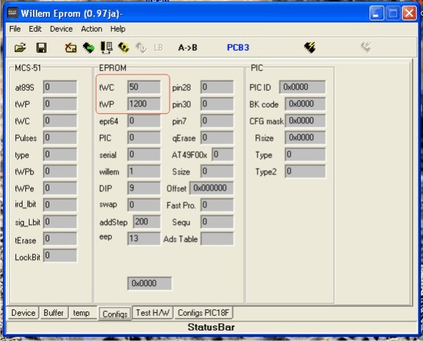

If you have low Vpp, check the 34063A and it's circuitry. Older chips as 2532 may need longer programming pulse, this is easy to set, see attached images.
Sliders for tWP and tWC
Check settings
Programmer with toroidal 100uH

Yes of course, I have set longer pulses before I post here. These old eproms are slow enough.
Your coil is much bigger than mine.
