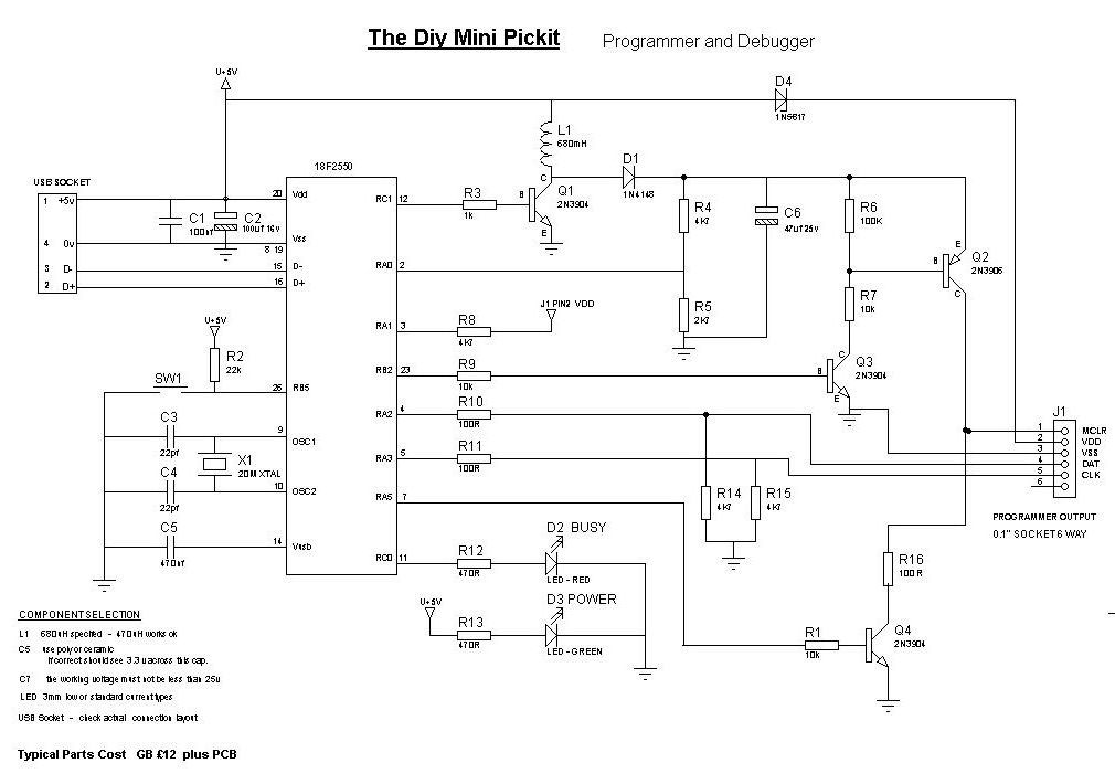

Hi..
I made a PicKit2 clone based on the following schematic...
When I connect this circuit to my PC and open MPLAB to connect PICKIt2 I see that the busy LED keeps on blinking and MPLAB keeps on loading... even if I wait for hours nothing happens until I disconnect PicKit2.... On disconnecting I receive this error..

Can anyone suggest what is the problem...
Below is a corrected diagram, the difference is on the USB socket, pin 2 and pin 3 connections are reversed.

3 questions, are you using a Laptop or Desktop ?
What voltage do you measure across the 4550 pins 19 and 20 ?
Do you have anything connected to the Pk2 outputs , a pic chip or a full circuit ?
Download from Microchip the Pickit2 program V2.61, that is a stand alone programmer and has lots of testing tools.
Connect using that and see what error it gives .

please test the programmer without connecting a PIC at its output, first set the Vpp to 12V or so, then try placing a pic for necessary programming.
change the C2 to 10uF and R10 and R11 to 47 ohms and then try gain. if necessary re load the firmware. perhaps some corruption might have happened.

aahaa... I finally got rid of that jamming issue.... now I am able to open Pickit2 V2.61 and it shows Pickit2 found... But there is another problem now... It shows me Vpp and VDD error when I try to program.... How should I remove this bug....
Good. Now note the exact error and try to reproduce. as already suggested, go to trouble shooting and check the Vdd and Vpp. during that time of testing, these voltages can be measured at the respective pins at the icsp connector wrt ground. Try to record and if necessary adjust the Vpp to 11.5V at lest. then restart and check
if any issue is there still, try to lift one limb of the inductor and add a 10 ohms resistor in series. test again.
1. when testing Vdd it gives "An external voltage was detected on the Vdd pin at 5.0 volts" however I have no external circuit connected to its output.
2. For Vpp test the software shows 12.0volts while on ICSP conn I receive 5.0 volts...
neglect the first message as your circuit is permanently watching the Vdd at the pic pin thro R8, 4.7K
the measurement for Vpp shoild be done across pins 2 and 3 of the icsp and not pins 1and 3.
yes even for pins 2 and 3 its 5.0 volts......
