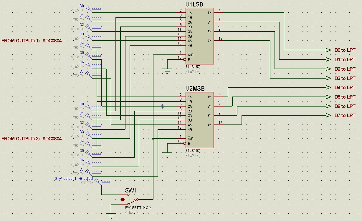

i want to send 16 bits , 8 bits then 8 bits via parallel port from 2 ADC to computer,
I don't want to use analogical MUX with one ADC, maybe a logical MUX with 2x8 bits input before sending to the parallel port (something like tri-state driver)
plz help me as soon as
circuit plz
The ADC0804 has a chip select(SC) and a read/write signal. The /CS/WE/RD signals must come from an output port or from a databus. The /CS for each must be decodes out of the address space if you use a data bus connection. If you want to read it through the microcontroller IO-ports you must generated the readout timing in software.
You can connect in parallel the outputs of both ADC, and use CS pins to read one after the other.
I've never dealt with parallel port before, so I'm guessing here that, since the parallel port uses TTL levels, you can connect them directly to the data lines of the port, and use status lines for controlling the ADC's.
yes, but if I connect the both ADC output i will have the data confusion in the output ( the last value of ADC still exist in the output and not in high impedance or opened collector))
you can use bus transceiver with tristate like 74HC245 to tristating the output of ADC, and then connect in parallel the output of both 74HC245 to micro...
Datasheet snip: "When data is to be read the combination of both CS and RD being low will reset the INTR F/F and will enable the TRI-STATE buffer latch output onto the 8-bit data bus"
There shouldn't be any collision as long at least one of ADCs is in tri-state mode (CS or RD high).
I am confused because the datasheets shows that the output will go into tri-sate if you have /CS at a logic high level. So not busbuffer are needed, if the /CS is used.
the circuit you shows is a bus multiplexer with input register. The bus buffer is only needed if you want to driver onger lines. Is this the case? If the connections between the ADC and the micro is on the same board the connection can be made directly to the bus or ports. If you want such a kind of bus multipler with connector the LS373 is beening replaced by the ADC.

Aha, so interfacing the ADCs to a printer port to read it out is what you want to do? If so, the document you have describes several principle methods, however it is not clear what kind of printerport you want to connect with?
Whichever is convenient and workable. SPP requires using input port four pins at a time, two nibbles for each byte. All the latest PC's have advance ports supporting 8 bit data read write. The link I posted gives EPP and ECP modes but I could not succeed in successfully using it at its full capability of 8 bits at a time.
Some tricky configuration is involved that I could not get it seems.
It is difficuilt for me to guess what it did not work. I know product which work this way. A few basic things comes to my mind which you could look at: the ADC needs to be initializes and a convertion start. The parallel port must be delayed until the ADC data is ready(/BUSY and nAk signal). The timing diagramm of the ADC read write must be met.
