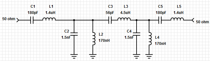

hi sir ,
i have a problem abort a 10MHz bandpass filter.
the parameters ;
BW>=3.5MHz, ripple<= 0.1dBa
retrun loss:-18dB
band rejection 55dBc@19.55MHz
group delay fluctuation 200ns
I think there may be a problem with the required BW and change in Gd allowed.
Is 3.5 MHz your max BW allowed?
ths for your solution,i had designed a similar circuit but the parameter of insertion loss can't achieve the target by board,so i have to use anther topology.
here is a best picture of waveform i had debugged.but ripple fluctuation >0.3dB.
the band ripple is too strict.it could hardly achieve the target on board.
