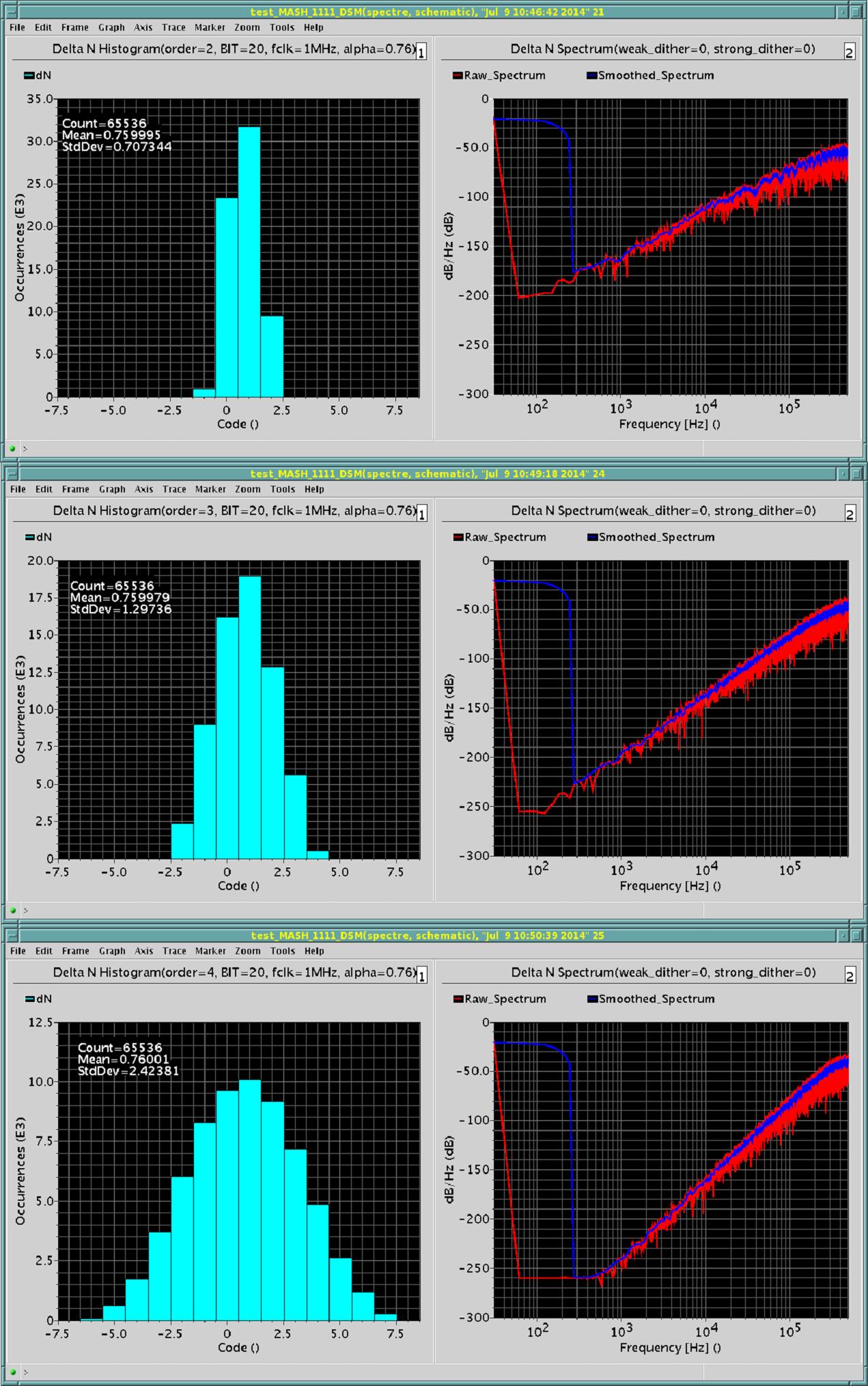

Can you surely understand very basics of DSM(Delta Sigma Modulator) ?
Instantaneous divide-ratio is Ninst = N + delta_N.
For first order Delta Sigma Modulator generates {0, 1} as delta_N.
N must be far larger than two.
For second order Delta Sigma Modulator generates {-1, 0, 1, 2} as delta_N.
N must be far larger than three.
For third order Delta Sigma Modulator generates {-3, -2, -1, 0, 1, 2, 3, 4} as delta_N.
N must be far larger than five.
So if order of your DSM is truely second, your descriptions are wrong completely.
Is order of your DSM first, isn't it ?

No.
It is true for any DSM structures such as CIFF, CIFB, and MASH.
Attached figure show MASH and CIFF.
If I understand you I can use only 1st order sigma delta for Dual Modulus Divider...
Ok, so from your explanation the second order sigma delta (used in fractional divider) should have 2 bits output that will change between following states :{-1, 0, 1, 2} but there is a lot of examples of 2nd order sigma delta that has 1 bit output. SO What are they use for? Are they used only for ADC/DAC conversion ?
Regards,
jackeeer
Yes.
Surely learn and study range scaling of DSM.
