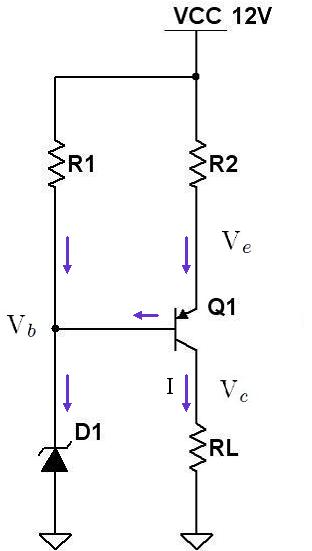

I am trying to have a LINEAR TRANSFER function using your recommended "Simple Current Source" solution; but I have first simulated the simple design example from the web page that you mentioned, and it doesn't work.
In theory, at Any load higher than 500 ohms will get less current, until eventually the collector junction will remain open and no current will flow (except a maybe a few picoamps from any leakage currents of the transistor). But this is not happening. I tried resistances above 500 ohms and the voltage continues growing.
Can you understand why?
Thanks!
First, you added the required resistor, but didn't make the other required changes. You need to take the voltage for R1 and R9 from the cathode of the zener(which is 9V). Your circuit is still using 10V as a reference.
As for your constant current source simulation: you've got a nominal 9ma current source (5.1v+.7v)/680. Then you put a 10K ohm resistor in the current path: 10K*9ma==>93V!!! Of course you're way outside the usable load range for this CCS. You have to determine the maximum resistance you want to measure, and then pick your current accordingly so that you don't saturate your transistor. For your circuit, the most voltage you can have across the load is about 6 volts==> 6/.009=>666 which is the maximum allowable resistance.

But coming back to my question regarding the Current_Source example, I have open 2 questions:
a) What will happen in the REAL_WORLD (not SIMULATIONS) if the R_DUT goes above 666 Ohms? (Will it break the PNP Q1 transistor? or Does it simply will not conduct as I understood? :shock:
b) Why in my simulation can I increase the R_DUT above 666Ohms and the transistor continues turned ON and the voltage across R_DUT continues increasing above +5V? :???:
Thanks!
Once R_dut exceeds 666, the CCS no longer provides CONSTANT current; the voltage will rise, but it will no longer be linear with respect to resistance as the transistor goes into saturation. If you need to measure higher resistances, you need to lower the current (by raising the value of R4. e.g.)
You won't 'break' the transistor. In your simulation you should be able to see the value of current through R5 is constant over a range of about zero to 666 ohms, and then it will decrease above that resistance.
To fulfill the voltage range specification, the current source needs to supply full output current up to 9.5 volt. The suggested circuit obviously doesn't. Also the current has to be reduced to about 0.39 mA. You'll face difficulties to implement the voltage range with 12V supply. A possible workaround is to increase the differential amplifier gain and adjust the constant current respectively.
For load and temperature independent current, I would refer to an OP current source.

1) Because you changed the reference for the top of your voltage divider from 9V to 10V!!! 590/(10000+590)*10=.557 volts, not .5V
2) Because the current from the CCS depends on the accuracy of your zener, Vbe, the hfe of the transistor (may vary from unit to unit), temperature effects, etc. A change of 10uA would cause an output change of 0.1V on the output with a 10K resistor. Is that acceptable for your application? You need to establish some requirements first, and then go from there.
3) There are a lot of ways to get more accurate current sources. For starters, use a bandgap reference (instead of a zener). Use an opamp circuit. Look on the web, there's lots of stuff out there.
