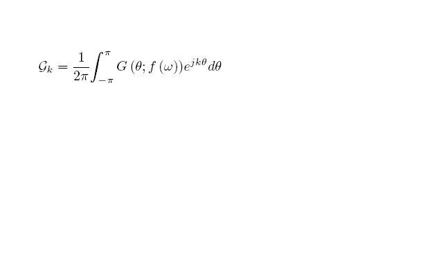

Hi all,
I must calculate this integral with matlab
and the code I wrote doesn't help. Please can anyone help me and tell where is the mistake?
NES=200;
w=2*pi*10^9;
for m=1:NES
teta(m)=-pi+2*(m-1)*pi/(NES-1);
end;
grondre=1/(2*pi)*trapz(teta,rectangular(teta,w).*cos(-k*teta));
grondim=1/(2*pi)*trapz(teta,rectangular(teta,w).*sin(-k*teta));
grondx=grondre+i*grondim;
Thanks!
you are missing information:
what is the 'rectangular' function? If you are making a window, you won't be able to make it 'w' long (w is 1e9 in length!)
What is the name of the function you are integrating? Could you explicitly write out what G(theta; f(w)) is?
thanks
G(teta,w) = rectangular, is the first part of the integration (the second part is exp(j*kt*eta))
and the code for G(teta,w)
function [G]=rectangular(teta,w);
c=3*10^8;
G0=1;
f=2*10^9;
h=[c/(4*f),c/(2*f),3*c/f,c/f];
ordin=2;
x=w*h(ordin)/(2*c)*sin(teta);
for k=1:length(x)
if x(k)==0
G(k)=G0;
else
G(k)=G0*sin(x(k))/x(k);
end
end
for the moment f(w)=w and w=2*10^9
