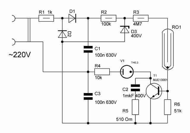

Recently collected such scheme

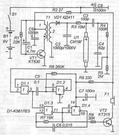

Another scheme:

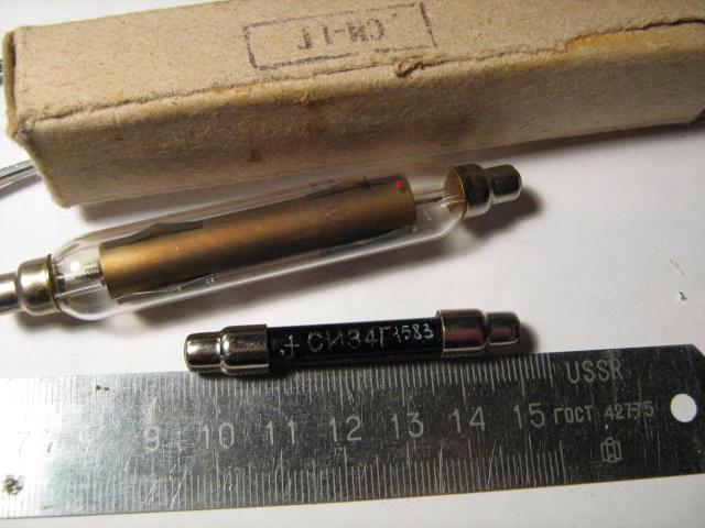

I think more simply to gain Geyger tube than try to force to work in this quality еlectrometer.
Though I tried as sensor neon lamp with coaxial electrode, like works, but sensitivity very low (voltage begin count around 50V). But for checking needs source to radiation too, may be useful some old luminous tumbler or instrument..

I bought a sbm20 tube on ebay for some $20...
the other tubes are really more expansive...
if it is to detect some cloud above you, the sbm20 is really enought !
