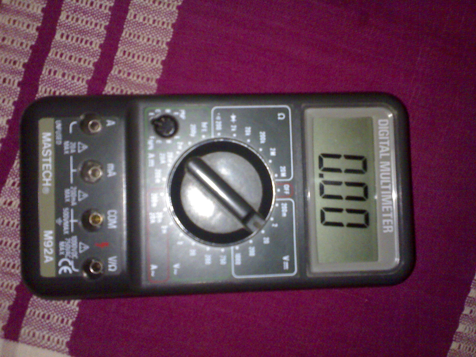

guys i have a multimeter but i have lost the test leads...
but i want to measure volts,ohms...etc.i used simple wire and somehow plugged it to the probes of the multimeter!
my problem is that --i used to measure the DC volts from a LM7809 ,but i got the result as 7.5 V
,even with the 7812,i got 9V!
is it the problem with the test leads!
it shows high precise with measuring the ohms...
what is the problem here!

If you are refering to a substandard multimeter which looks like the one in the picture, you bought for 300/- Rupees or 6$, it is worth for what you paid. You'll get better quality and accuracy but for a price...Cheers

guys but i measured the output voltage from a nokia charger (5.7V/800mA) and the meter read 5.8V...
this shows it is working well,but when i measure the DC volts from a LM7809 , i got the result as 7.5 V
multimeter doubt!
Post the schematics of the LM7809 and LM7812 power supplies so we can show you what causes their voltage to be too low.
If their input voltage is too low then their output voltage will also be too low.
Maybe your meter is wrong. The output of the 5.7V charger will be 5.7V only when it has its full rated 800mA load current. Its voltage could be 7.3V or more without a load but your meter wrongly shows 5.8V.

guys at last i repaired my multimeter!
i kept the probe to a nokia charger(5.7V)i opened the multimeter and and changed the pot inside it till i get the readings as 5.7..and i got it!
and to further test it i connected it a SMPS 12V...
and i got very very precise and accurate readings as 12V!
now my multimeter is perfect and fine
but the other thing is that i said u before that i got 20V from a 12DC....
the real thing is that i have a 12V AC/1amp converter....
i used a bridge rectifier of 1n4007 and converted the AV to DC...
but when i measured the output i got 20V!
the multimeter was perfect..
and i came to know that the converter is the problem!
can u tell me what could be the problem!

this is my multimeter!
The peak of 12VAC is 17V. The rectifier drops 0.6V or 0.7V then the resulting 16.3V charges the filter capacitor and the output is 16.3VDC.
A power source might not be regulated so its output voltage could be very high without a load.
Meters are calibrated by adjusting them to read the same as an accurate standard one.
