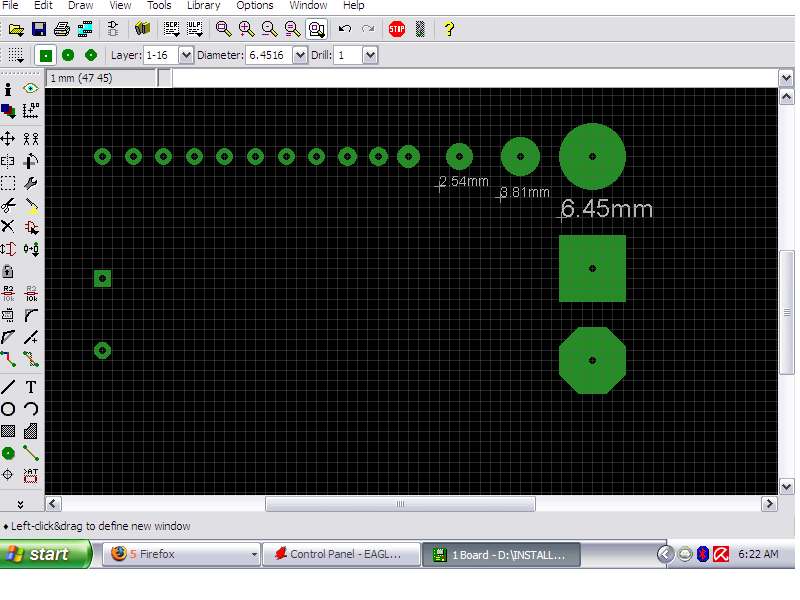

Hello friends i want to change pad size in eagle but the given pad sizes are in diameter of 2.54,3.81,6.45mm but inbetween sizes are not avilable i need 2mm, 3mm,3.5mm,4mm,4.5mm,5mm,5.5mm,6mm,6.5mm pads so please tell me how to change the pad sizes as per our needs is there any library avilable of different pad size . please help me its very urgent...

Type in the desired diameter and drill size in the boxes marked in attached image.

What you are placing is actually "via" not "pad". Eagle doesn't support long shape for via. For changing pad shape you need do it in library editor.

The command to use is "change shape"
You can do this directly on the brd if it's for a via, otherwise if you want to change the pad of a component you have to open and edit the relative library
