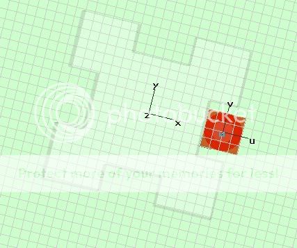

I changed my Port to the whole feed, and I got this farfield:
https://i262.photobucket.com/albums/ii115/elanu/field2.jpg ---- dielectric material epsilon 60 and mue 1.2
The way i changed the port is that now it looks like this:
https://i262.photobucket.com/albums/ii115/elanu/port.jpg
before it didn't touch the PEC of the fractal.
However, i believe that my s param in dB still is wrong, it looks like this:
https://i262.photobucket.com/albums/ii115/elanu/params2.jpg
Ah ok, I have misinterpreted your pictures.
The radiation pattern looks better.
From the port picture it looks like that the port is beside your Fractal?
Can you try it with the port inside the fractal?
If this works you have to vary the port position. When the port position changes the impedance changes and so the S11 parameter.
You have to find the port position with an impedance near to 50 Ohm, or other expressed with a good S11 value.
The S11 is good if it is at the desired frequency in the region or below -10dB
Reactions: elanus

Yes, the port is besides the fractal.
So, if I understood you corectly, i have to variate the posistion of the port so that i get my S11 parameter somewhere below -10 dB ?
How do I find the port position near 50 Ohm ? I am asking this because i need to have the impedance around 50 Ohm, so this is very important.
Any idea how can i change the position of the port, without drawing it again ?
Also, if i have to draw it again, does the port need to "pass through" the fractal ? or it must "extend" from the other side until it "meets" the fractal ?
